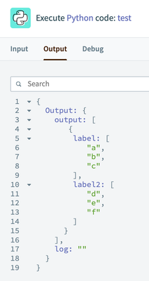

"Internal Error" usually means something else is going wrong within your script. I suggest running the script in another IDE to figure it out (better logging and error reporting), or simply start with a simpler script in the Workato action to ensure the basics are correct.
I wrote this simple code to return your intended output and it works perfectly. This suggests your script is crashing elsewhere, or it's not generating the output object the way you expect it to be formatted.
def main(input):
     return {'output': [{"label": ['a', 'b', 'c'], "label2" : ['d', 'e', 'f']}]}
Quick note: I didn't write an output schema for the Python action. This is the default output.
As an alternative, you can use Ruby or Javascript ; )

I am getting an "Internal Error" when I try to run the recipe.
def main(input):
