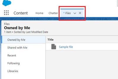

In which object are you storing/referring those files in Salesforce? If you are storing the files/documents in Files(Object will be 'Content Document'). Then you can implement the below approach to sync the files b/w 2 envies.

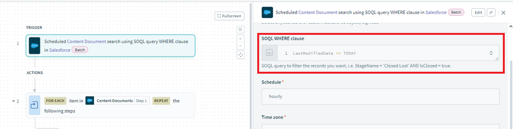

1. Create a connection with the primary Salesforce application which is a source
2. Create another connection with the secondary Salesforce application with the target SF account
These configuration will let you use 2 accounts of the SF in the same recipe(secondary connection will be your 2nd SF account).
And followed by the recipe setup to accomplish your requirement.
Recipe Link: https://app.workato.com/recipes/46861544?st=024867be6c69d662b03dc144d390e46d785a367702df0b779f460756...
In the trigger you can change the SOQL query as you need.
