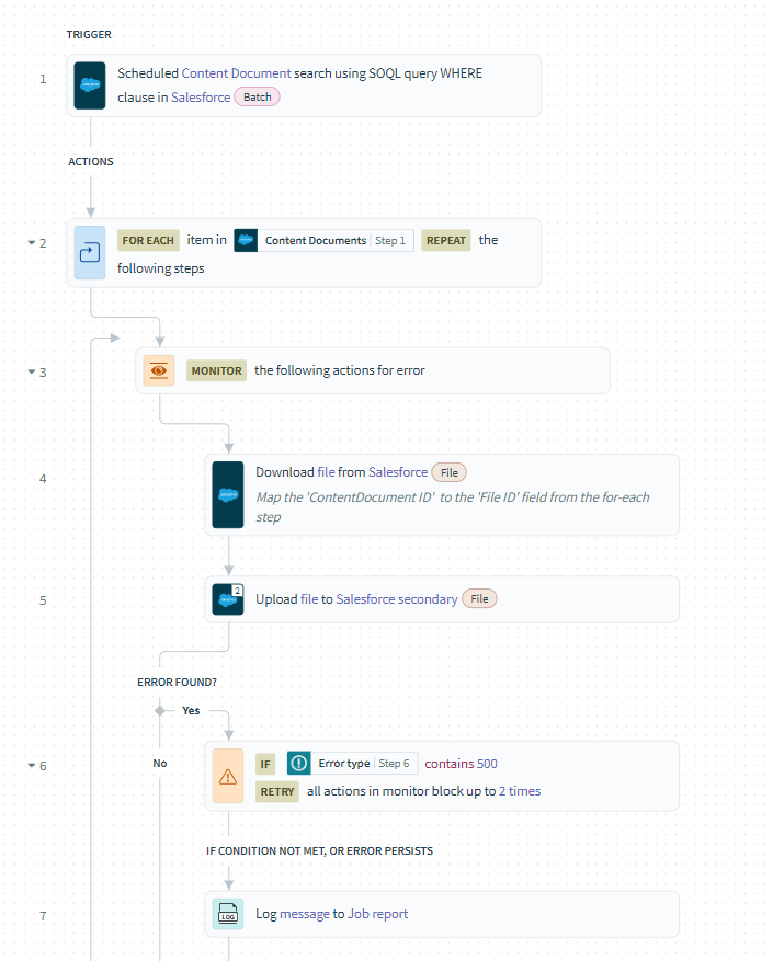

Oh! okay, I'm not sure how can I provide the recipe link which supports you domine url. But, I can provide you with the snapshots of the recipe built. So that you can build and configure accordingly
Here is the recipe snap -

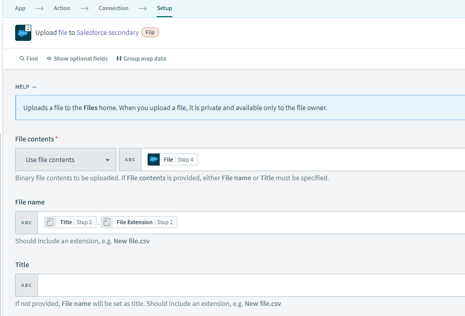

Here is the configuration for the step 5-
Note: This is just a sample recipe to sync the files from one environment to another. You might need to do/alter some of the steps or add additional steps/configurations to meet your requirements.
You can refer the link for more information: https://docs.workato.com/connectors/salesforce/salesforce-generic.html#create-update-search-upsert-a...
