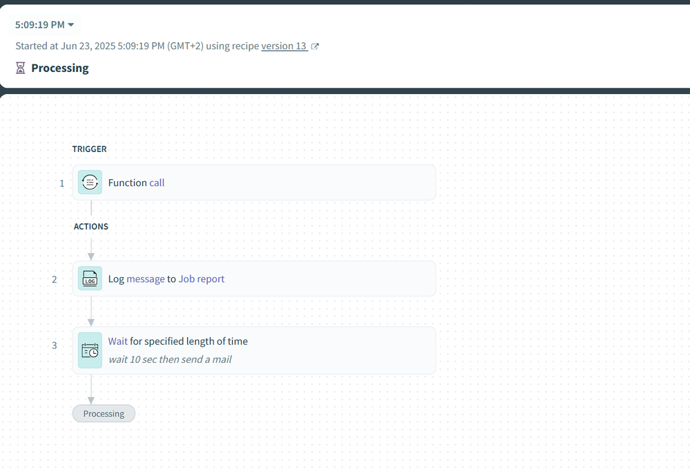

Hello,
I'm facing the same issue as initially described. What I want to achieve is in the rate of an api rate limit issue, instead of stopping the process, I want to set it in pause till the rate limit reset.
I tried what was described as a solution but the workato schedule never restart the process. I'm in UTC+2 can this be an issue with the workato reference date which seems to be Pacific time ?
I tried to understand using a very basic recipe.

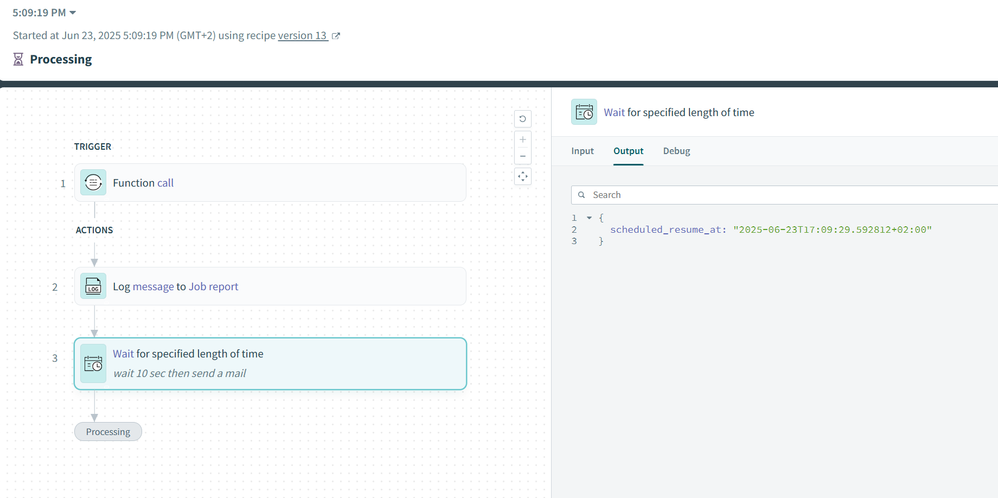

Logging the current time, waiting for 10 sec   and after I was expecting an email.
The second screenshot showing the 'scheduled_resume_at' value was done @ 5:15 PM
Did I configure something wrongly ?
Thanks for help,
Philippe
Scheduler doesn't work when testing recipes. To "test" it, you need to start the recipe and call it.
