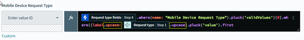

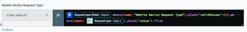

My requirement is to return the Value "value" among all the options ("validValues") of the field whose "name" is "Mobile Device Request Type" and whose "label" is equal to the input parameter "Request type".
I found this way to do it:
But with the "where" is try to find an exact match. That mean "New Order" <> "new order".
Is there a way to do something like:
Thnaks in advance

I find "where" very restrictive, and in most cases when I have to parse a complex array I use a Ruby action and different methods like filter, find, type, etc.
My suggestions:
  1. You could upcase the entire API response in a JSON parser, and then upcase your request type
  2. You could input the API response into a Ruby action and parse it with different methods andmore flexibility
