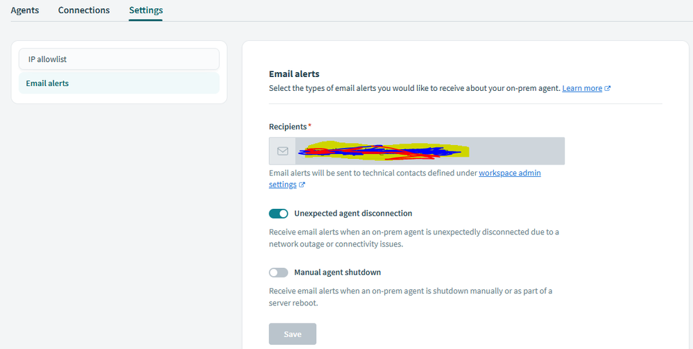

Hi @gnaneswar ,
Just to avoid the failure cases always follow below best practices
  • Use filter conditions (trigger conditions) to prevent sequential trigger errors.
  • Always include the appropriate email addresses to receive error notification emails in case of OPA or connection failures.
  • If you decide to use a scheduler, try to match the polling time used by SMB to avoid creating unnecessary tasks.
Thanks and Regards,
Shivakumara K A
