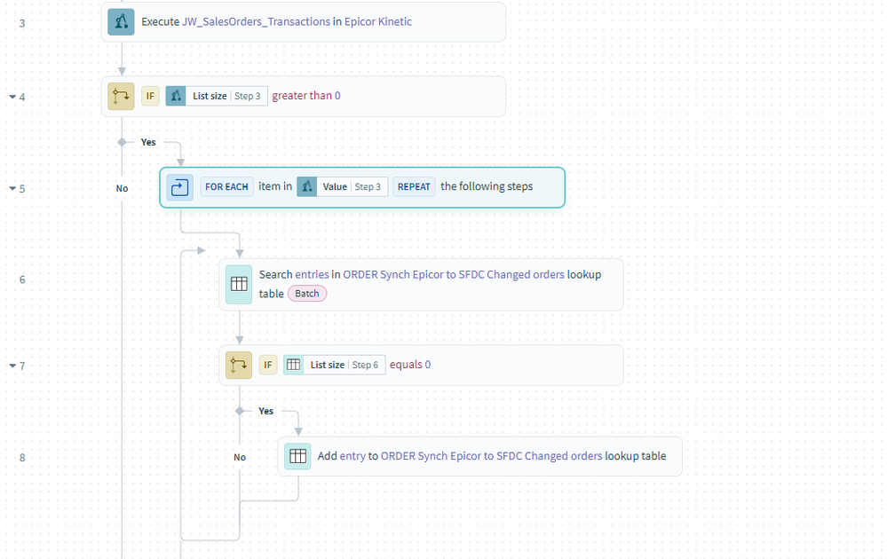

here s my recipe where Step 3 runs the BAQ and gives me lest say 20 records but only 3 unique records
I do the if to make sure its not empty and then loop through all the records... so it seems pretty straight forward just not sure how t insert this pluck unique before the loop step

Are you trying to loop through only the unique records?
What you're trying to accomplish is something Workato makes very difficult to do. I'm happy to explain how to do it, but I want to make sure I understand what you're trying to accomplish before I spend the time.

yes... I just want to loop through the unique records
where the record would be 2 fields Company and Sales Order number
