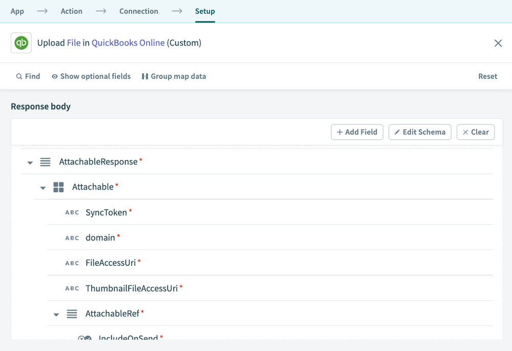

1 ACCEPTED SOLUTION
juliana-recio
Hi, @jeremyburns2256
Good day! Apologies for the delay in response.
Here's a sample setup we have successfully tested on our end.
Screenshot 2024-06-10 at 2.32.07 PM.pngScreenshot 2024-06-10 at 2.28.51 PM.pngScreenshot 2024-06-10 at 2.31.28 PM.pngScreenshot 2024-06-10 at 2.33.44 PM.png
Hope this helps!
juliana-recio
