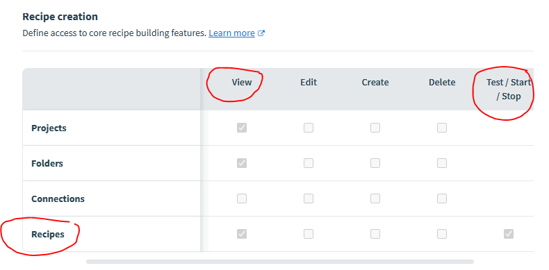

Hi @sidjayawardena ,
Use of RBAC:
Step 1: Select Projects (RLC)
Step 2: Create a Role with “Operate” permission
Use Workato’s RBAC to create a custom role or use a predefined role like:
  • Operator – Can only start, stop, and retry recipe jobs. Cannot edit recipes.
  • Production Operator (in RLC projects) – Same as above, scoped to Prod.
They can run recipes manually
They cannot see or modify recipe logic
Step 3: Assign that Role to the User
  1. Go to Admin Console → Users
  2. Assign the user to the project/environment
  3. Give them “Production Operator” or “Operator” access to the project
