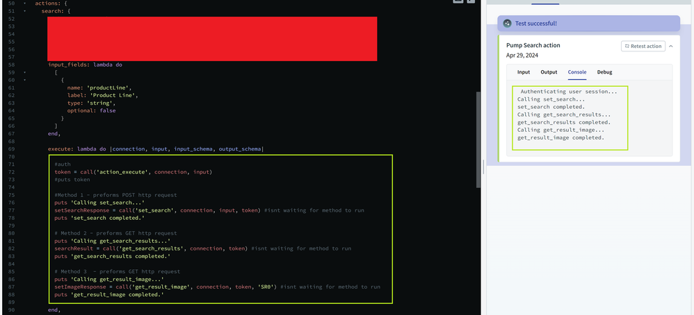

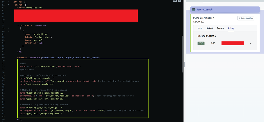

Im seeing a strange issue when using methods in Workato connector SDK, if i call one method after another in the action execute Workato does not wait for the method to complete / respond before calling the next line, as can be seen in the image below each of these methods is responsible for a https callout but only the initial auth call is made and log lines are called.
I have tried adding log lines to the start of each method (which are being logged) so the methods are being called but Workato doesnt seem to be waiting for the callouts / method to complete before moving on (the http call outs take less then 2 seconds to complete).

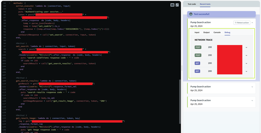

If I chain my callouts together in the methods (after_response) i can see Workato runs correctly but these methods are supposed to be stand alone and wont always call the next method like I have in this example.
