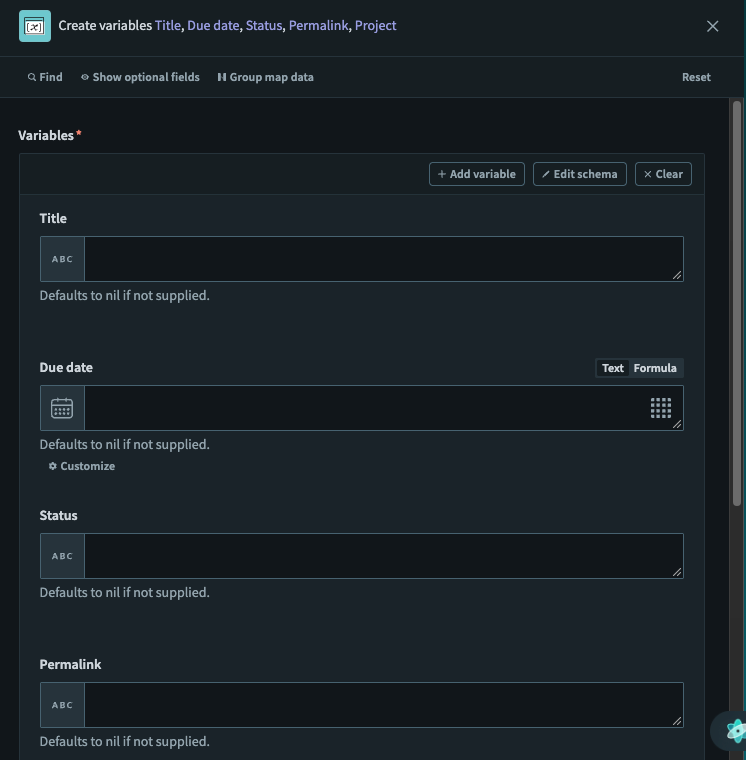

currently i am trying to set up a system that will automatically email our employees there wrike tasks at the beginning of every monday. my knowledge on the builder and formulas is limited, so i have been having people help me and also getting help from Gemini to help. my issue is that in step 5 of my recipe, i was told to "Create a Variable -> Label: Tasks Due this Week -> Data Type: List".

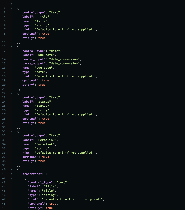

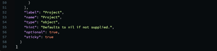

From there I updated the schema to this
Screenshot 2025-06-19 at 3.20.13โ€ฏPM.pngScreenshot 2025-06-19 at 3.20.24โ€ฏPM.png
After doing that, my table looked like this.

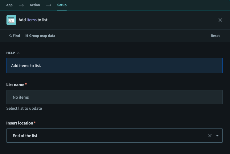

However, after this I made a repeat loop
But after the that, It ask me to add the list "Tasks Due This Week", and no matter how I changed the schema or messed with other parts, I could not get it to appear in "List Name"
If anyone has any guidance, it would be greatly appreciated!

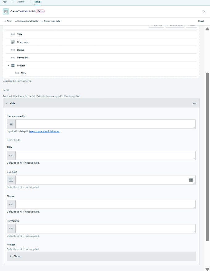

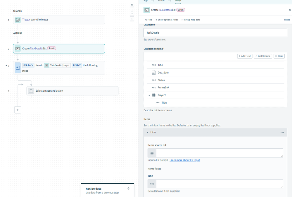

Bhagya_pola
Deputy Chef III
Deputy Chef III
Hi @collin_baker_4
To loop you need a list, instead of creating variables go with list.
In variable by workato choose action as Create List (Batch)
then create some dummy field in it and then edit schema of it completely with below one and name the list
then you should be seeing the list to map in loop
    "control_type": "text",
    "label": "Title",
    "name": "Title",
    "type": "string",
    "hint": "Defaults to nil if not supplied.",
    "optional": true,
    "sticky": true
    "control_type": "date",
    "label": "Due date",
    "render_input": "date_conversion",
    "parse_output": "date_conversion",
    "name": "Due_date",
    "type": "date",
    "optional": true,
    "sticky": true
    "label": "Status",
    "name": "Status",
    "type": "string",
    "optional": true,
    "sticky": true
    "label": "Permalink",
    "name": "Permalink",
    "type": "string",
    "optional": true,
    "sticky": true
    "properties": [
        "label": "Title",
        "name": "Title",
        "type": "string",
        "optional": true,
        "sticky": true
    "label": "Project",
    "name": "Project",
    "type": "object",
    "optional": true,
    "sticky": true
 Please refer the below images Screenshot 2025-06-20 012423.pngScreenshot 2025-06-20 012457.png

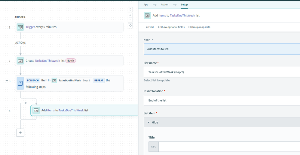

Pavithra_C
Deputy Chef I
Deputy Chef I
Hi there! @collin_baker_4 ๐Ÿ‘‹
This is a common point of confusion when working with lists in Workato.
Instead of creating a list using the โ€œCreate Variableโ€ step, you actually need to use the โ€œCreate Listโ€ action from the Variables by Workato. This is an important distinction because:
  • The "Create Variable" step does not support iteration in a repeat loop. (For this iteration process we need to parse the Variable output).
  • Only a list created using "Create List" can be added to using "Add item to list" and we can iterate overusing a "Repeat Action".
Here's what you should do instead:
  1. Use the "Create list" action --> Need to create a "TasksDueThisWeek" list with the payload structure mentioned by you.
  2. Then, use the "Repeat action" and select your newly created list (TasksDueThisWeek).
  3. Use the "Add item to list" action inside a loop or conditional logic to populate it with your tasks data.
Let me know if it works to you โ€” happy to help further! ๐Ÿ˜Š
