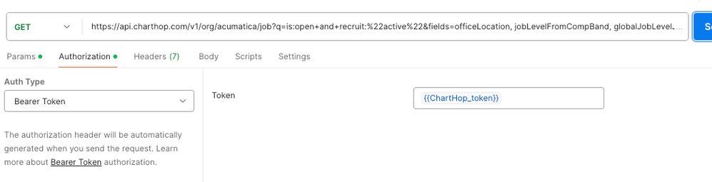

I am trying to create a connection to ChartHops job api. I was provided an api token, and I can use this in Postman to get the data I am looking for. However, I am not able to get a connection to work in Workato. In Postman I use the auth type "Bearer Token" but I don't see anything like that in Workato. I tried Header Auth but that didn't work.

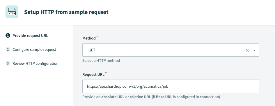

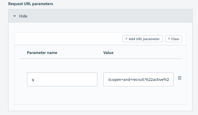

Hi @Prajwal
This is how I have Postman configured for this ChartHop endpoint. There are no additi9nal jeaders other than the ones Postman generates.

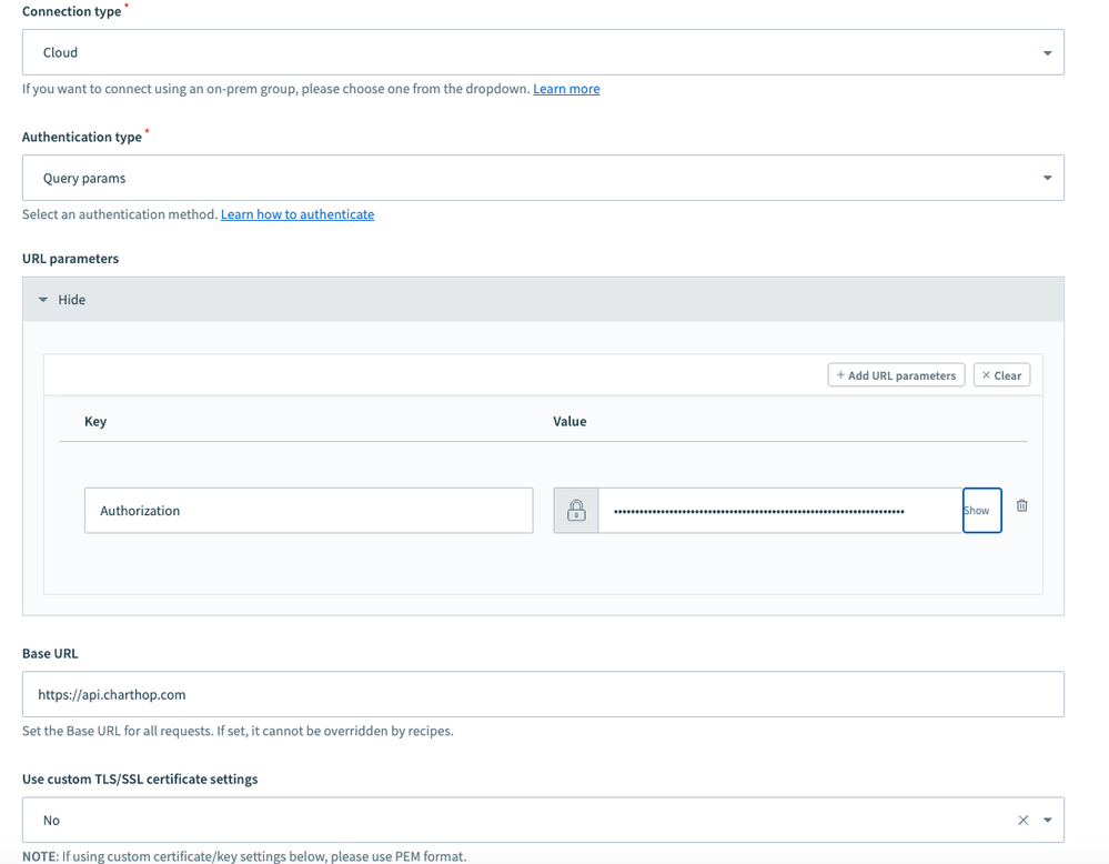

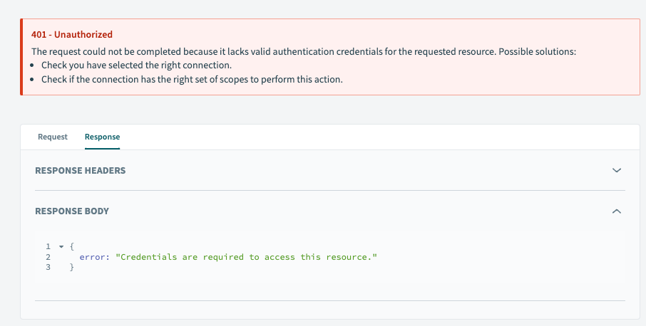

This is how the connection is configured in Workato. I have tried apikey as well, but still get 401 errors. None of the other Auth types seem to apply. I'll sen another reply with screenshot from the guided setup.
12-09-2024 07:03 AM
Hi @Prajwal
Screenshots from the guided setup. Do I need to set it up manually? I tried that last week with the same results, but can try again. I'm missing something. Thanks for your help.
12-09-2024 09:36 AM
Hi @Prajwal
I was able to get the connection to work using Authorization as the key and Bearer <apitoken> as the value. It took me a few minutes before it dawned on me that you meant to actually include the work Bearer in the string. 🙂
