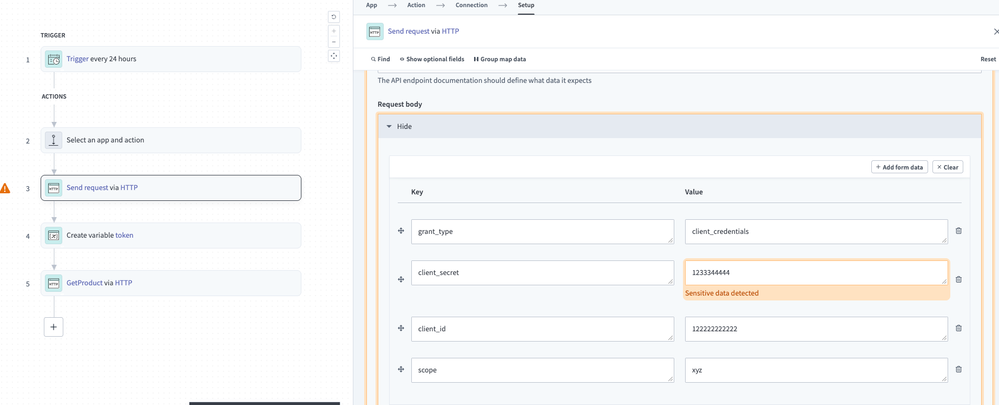

However, when I select the HTTP action (Choose from App), it asks for the URL (which is fine), but it also asks for additional details in the request body, such as grant type, client credentials, etc.
My question is: if I have already created a connection and I am using that connection in this recipe, why is it asking for these details again? I feel like I might be missing something.
Getting this error when testing the Recipe, although the client credentials are already available in the connection.
401 Unauthorized { "error": "invalid_client", "error_description": "AADSTS7000216: 'client_assertion', 'client_secret' or 'request' is required for the 'client_credentials' grant type. Trace ID: **** Correlation ID: **** Timestamp: 2026-02-12 22:48:01Z", "error_codes": [ 7000216 ], "timestamp": "2026-02-12 22:48:01Z", "trace_id": "****", "correlation_id": "9c8ff63c-5f6c-43c3-88e3-360e5c0c768a", "error_uri": "****" }

Hi  @shivakumara

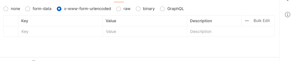

Yes, you are absolutely right. The request works fine when I send it from Postman.
It is also working from the Workato HTTP connector when providing the details in the Request Body.
However, I’m unsure how to properly provide the credentials when adding the HTTP action in my recipe. I have already created the connection successfully.
For testing purposes, I am currently passing grant_type, client_secret, client_id, and scope directly in the Request Body, which I understand is not the correct approach.
