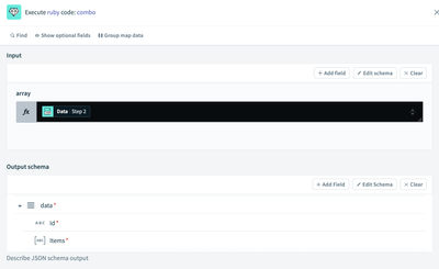

You can do this in a Ruby action using the below code. This way you don't have to loop through your array and burn a whole lotta tasks :
data = []
records = input["array"]
ids = input["array"].pluck('Id').uniq
ids.each { | id |
obj = {}
items = []
records.each { | record |
if record["Id"] == id
items.push(record["Items"]["Item"])
end
obj["Id"] = id
obj["Items"] = items
data.push(obj)
{data: data}

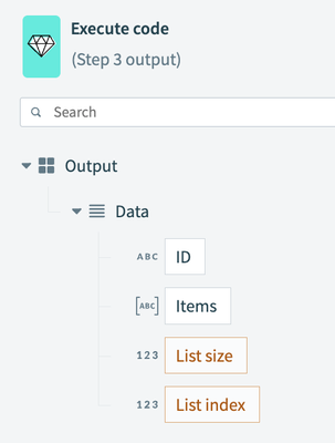

Parse your JSON input first and then set up the Ruby action like this:
Output:
data = []
ids.each { | id |
obj = {}
items = []
end
obj["Id"] = id
data.push(obj)
{data: data}
Output:
