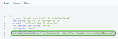

Hi @wilbert
Please check your input for the groups field. I have an example also using multiselect and the selected fields are given as an input with a space separator:
For this, you should add the property: delimiter: " " to your groups input field. And then finally I convert the given String into an Array right for the HTTP request:
includeDemoBoardData: _input['includeDemoBoardData'].split(" ")
Hope this helps!

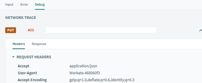

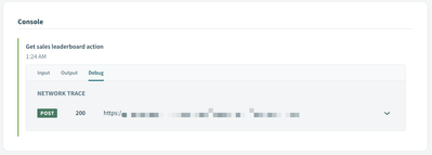

Hi @wilbert, once you test your action in the SDK, you should already see the HTTP-Request details including the playload sent to your API-Endpoint. Can you confirm it is not shown?sdk-http-request-debug.png
That what I expected but it is not the case. I do not see the request body. Maybe because it is a PUT request? I just see the headers
