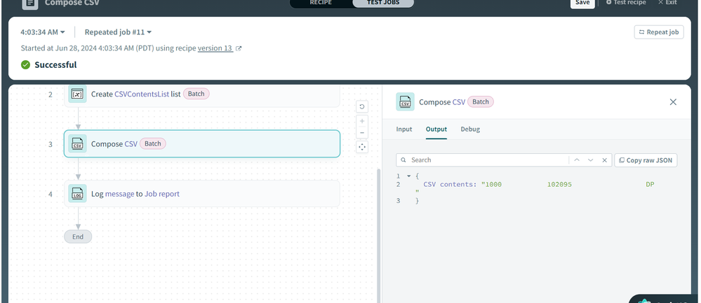

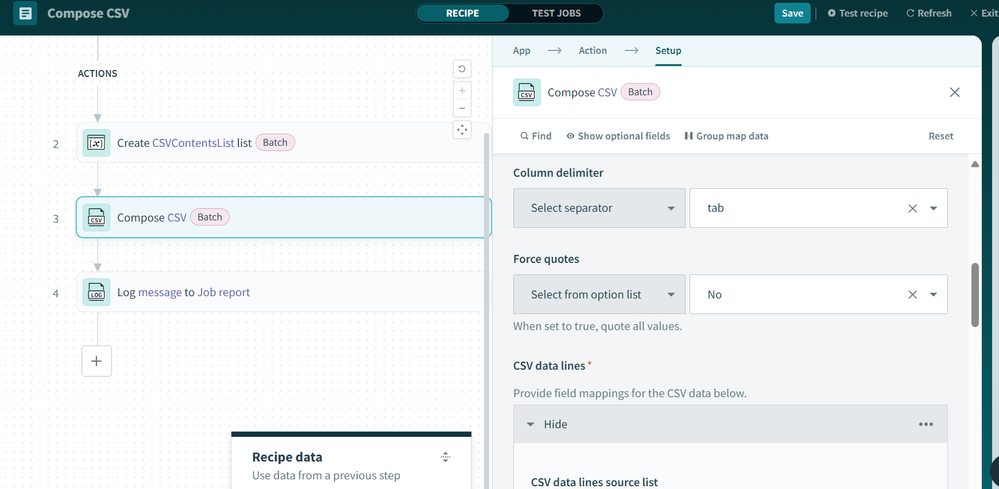

I am creating CSV files (technically TAB delimited) using Compose CSV. I am using a List for the source.
I have the option to Force Quotes Set to NO, yet for any fields where I am not supplying a value (as they are not required), double quotes are being inserted.
This does not seem to be correct to me as I should be able to have no values between delimiters without Quotes.
eg:    1 000[TAB]102095[TAB][TAB]DP[TAB][TAB]March
Instead, I am getting this:
1000[TAB]102095[TAB]""[TAB]DP[TAB]""[TAB]March

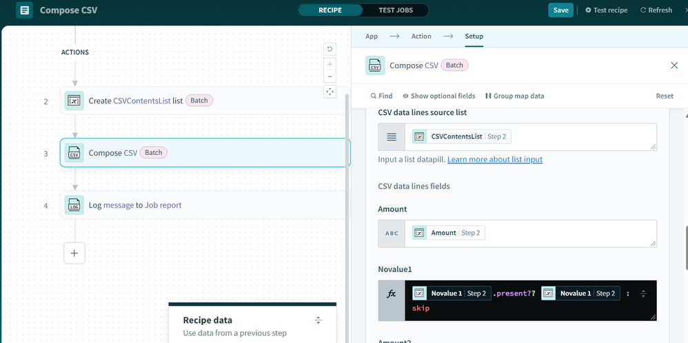

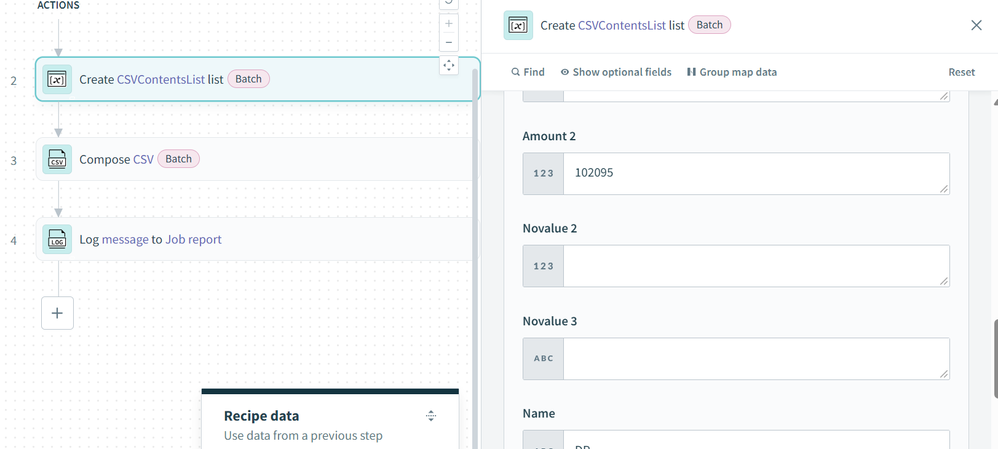

Hi @klandry ,
We have found a solution to the problem you are having. The problem comes from the array values โ€‹โ€‹you pass to create the CSV.
1. If the field value is empty, ""(double Quote) problem occurs because the empty value is called "" (double quotes).
 In this case, we operate differently at the source or target level.
โ€‹Example: 1000 NoValue 102095 NoValue DP
In this case you can use Value.present?? Value: skip
Here is an example of a recipe screenshotPlease check it out and let me know if you need help..

Hi @klandry ,

Thanks very much for that solution. This will work for me.
You've saved me from pulling the rest of my hair out.
