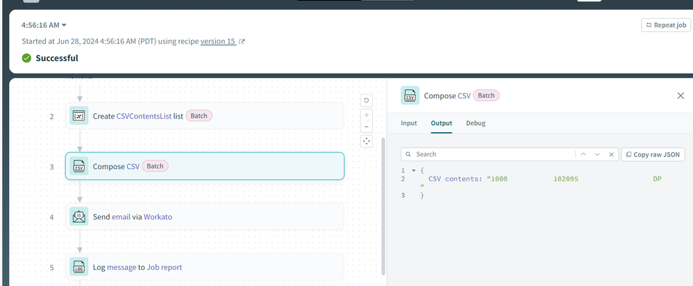

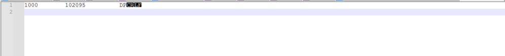

I tried with an example where I found that it is creating with CRLF only. Let me send you screenshot of the recipe with CSV data showing with CRLF at the end of the line. Please check again from your end and let me know if you need further assistance. Sending an email
Contents ending with CRLF
Composing CSV
