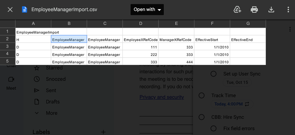

Hey all - I need to compose a CSV in Workato that I am not sure is possible, here is my criteria (screenshot below):
Row 1 has to be as follows: EmployeeManagerImport,,,,,,
Row 2 has to be as follows: H,EmployeeManager,EmployeeManager,EmployeeXRefCode,ManagerXRefCode,EffectiveStart,EffectiveEnd
Row 3 has to be as follows: D,EmployeeManager,EmployeeManager,{dataPillValue},{dataPillValue},{dataPillValue},{dataPillValue}
As you can imagine, row 1 is really where issues are being caused. Row 2 is effectively the header row, however I need the value in A1 and the subsequent blank cells in order to tell the system what action to perform.
Has anyone else run into a similar custom CSV formatting challenge like this?

Assuming you can make the CSV for rows 2 and onward without issue, all you need to do is add the header row -- like, literally "text add" the row to the beginning of the CSV.
"EmployeeManagerImport,,,,,,\n" + [CSV data pill]
The "\n" is just a line break so it doesn't merge with row 2.
I just tested this and it works.
