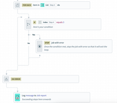

Hi @prp_proton ,
It depends on your use case; for example, if you want to stop the loop after several lists or indexes, you can add a condition and a monitor action to move to the next step in the recipe. Here's an example:

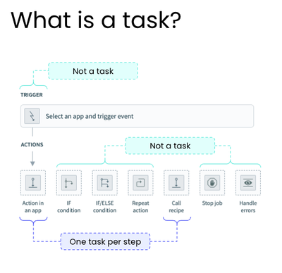

Javier,
It has always been my understanding that calling a Recipe Function consumes a task.  It was a big bone of contention for me when I found out and I brought it up to my CSM multiple times.  I've never heard back that it didn't consume a task.  When I read your post I thought maybe Workato had changed its policy to ignore those actions now, but in looking at a job this morning it still seems to be consuming a task:
mppowe
You are correct. Calling a recipe function will consume 2 additional tasks per loop: one when calling the recipe, and another for the Return action. Please refer to the screenshot below for reference.

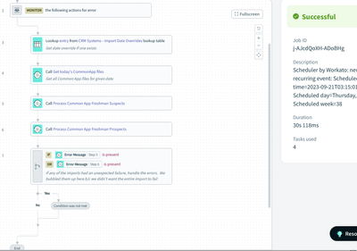

If we are using the catch break..... it will show error in the job report. which is actually misleading. Thats why looking some another solution.

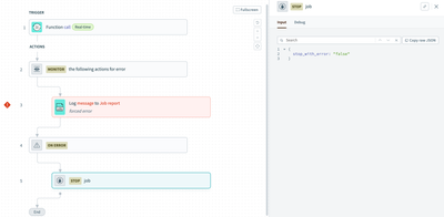

If you're referring to the error monitor, it doesn't automatically mark a job as failed in the job report. The job viewer will still show which action had the error, but the job could be configured to stop successfully or failed.
Job report:
Job viewer:
