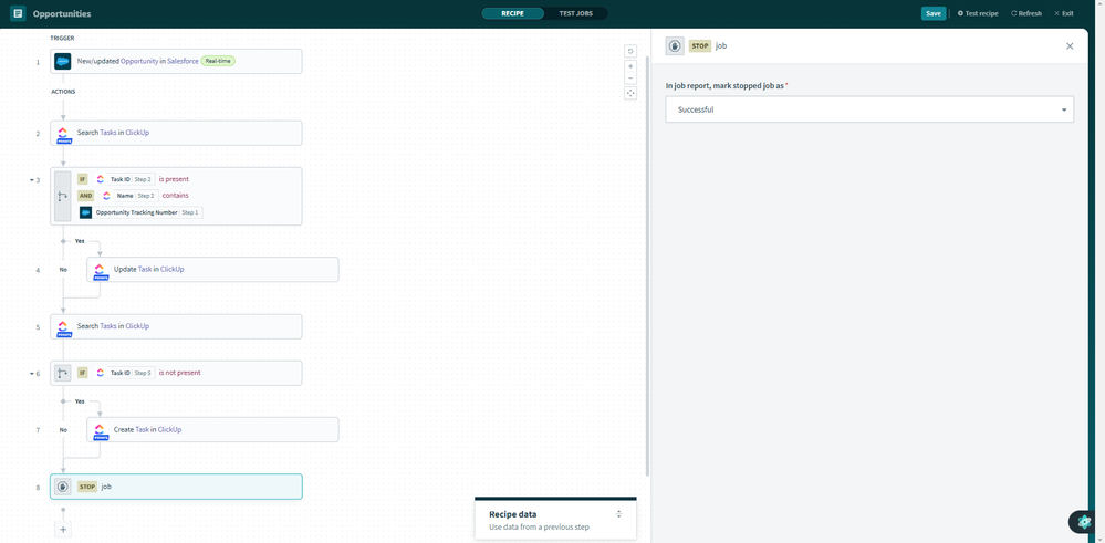

I have a recipe to create a task in ClickUp every time an Opportunity is created/updated in Salesforce, and I'm getting an error I can't understand .

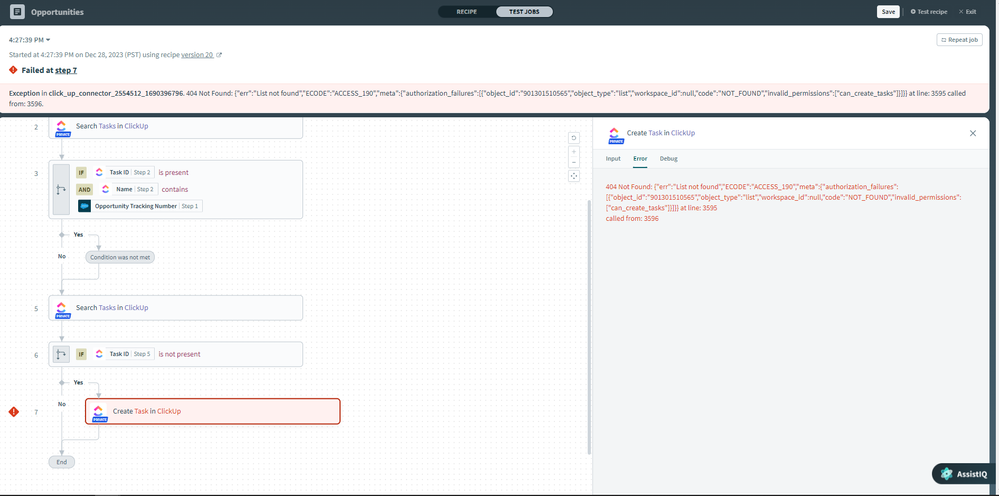

Error: 404 Not Found: {"err":"List not found","ECODE":"ACCESS_190","meta":{"authorization_failures":[{"object_id":"901301510565","object_type":"list","workspace_id":null,"code":"NOT_FOUND","invalid_permissions":["can_create_tasks"]}]}} at line: 3595 called from: 3596
Here's the recipe:Recipe
Here's the error: error

404 error commonly results from a value being passed that doesn't match any of the existing values or records from an app.
Looking at the error message, it looks like your Authorization is not correct. Have you checked and tested the ClickUp connector especially the Authorization? Did you create the connector and use the Debug under the SDK tool?
