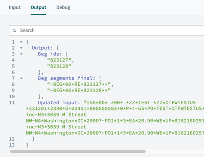

I don't think all of this could be done in a single line (at least not by me!), so I wrote a quick code snippet you can use in a Ruby action. It will output the following:
  • begIDs: an array of BEG ID values
  • begSegmentsFinal: an array of updated BEG segments after replacing *RL* with *RE* -- this is mostly for reference, but I included it anyway
  • updatedInput: this is the entire string input updated after replacing *RL* with *RE*
Here's the actual output:

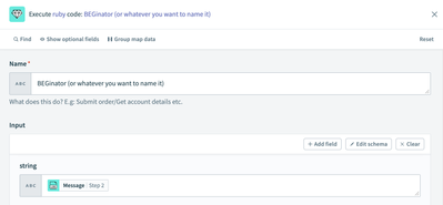

Set up a Ruby action with one string input called "string", and pass in your string.

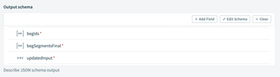

Set up the output like this:
