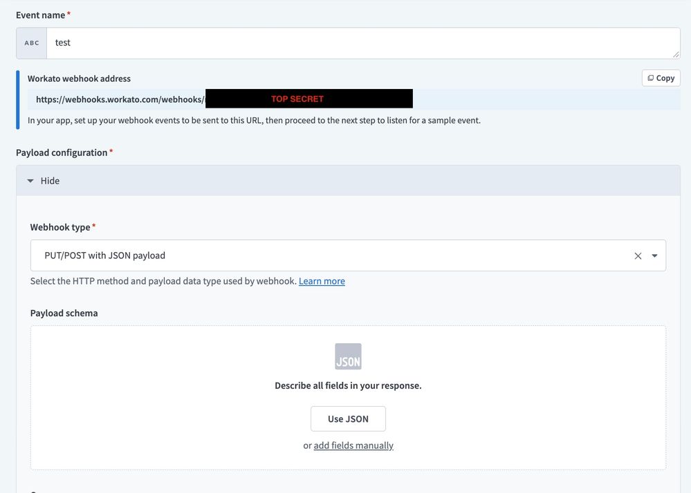

Here's my webhook trigger, completely undefined other than POST JSON:
Here's my cURL to call it from Terminal:
curl -X POST "https://webhooks.workato.com/webhooks/rest/top_secret/test" \
-H "Content-Type: application/json" \
-d '{"event_type": "do stuff", "anything": "yadayadayada"}'

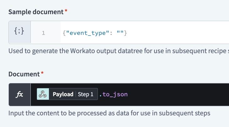

Here's my JSON parser to capture the event type:
And that's a wrap!
From here you'll have your event type parsed, and then you can route to other JSON parsers. When calling other functions, do the exact same thing as the JSON parser: pass the Payload as .to_json and parse it in the next recipe.

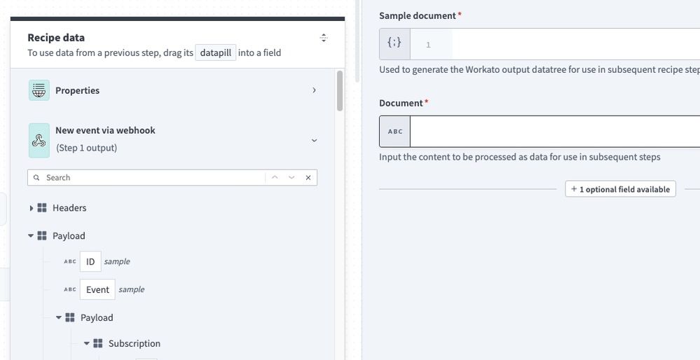

The walk is verily CONSTRUCTED OF PURE CAKE... it's just... I still can't see how to stuff the incoming Payload into a JSON parser. The "Document" field in the JSON parser Action wants to take indiividual fields (e.g. Id and Event) from the output of my Trigger (see screengrab below)...
How do I pass in ALL OF THE JSON PAYLOAD into the Document field of the JSON Parser?
The issue may be caused by my having based this Trigger on the JSON generated by the Guided thingy, I guess?
