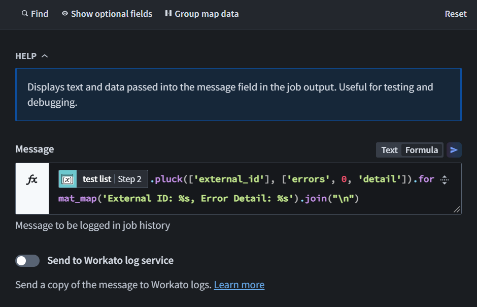

I got the solution for the problem , we just need to extract both the field in array format then use format_map %s notation to fetch the value from nested array.
 You can check out the documentation as well herehttps://docs.workato.com/en/formulas/array-list-formulas.html#format-map

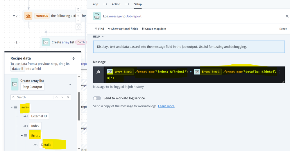

Hi @amaan ,
Here is one of the solution,
Please let me know if you have any question.
Thanks and Regards,
Shivakumara K A
Hi @shivakumara , thanks for the input but this approach does not solve the requirement i want each object to aligned with proper external id along with its error detail , the solution you posted will give first object detail of errors list only and that too at the end, not along the external ids.
