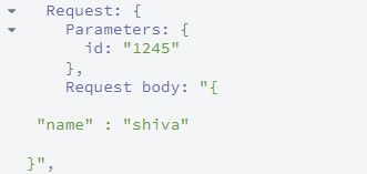

Hi @jmcvicker ,
When you set up API end point (refer to below end point)
end point: https://apim.workato.com/poc/employee/{id}
Testing: when you hit the end point, you can see the parameter in the response of an API end point.

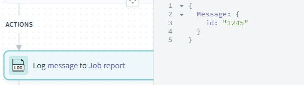

Solution: Add the logger or variable, map the parameter object respectively in formula mode.
