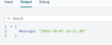

Here's a sample formula that you can use. You can use .to_time formula for converting an epoch value.
Output as a valid date:

Thanks @marlon-muela This worked like a charm. One question though. The default time returned by this formula is in UTC or PDT ?
โ10-30-2023 05:57 AM
I believe that this is based on the account settings. You can use .in_timezone formula to convert the date/time into a specific timezone.
