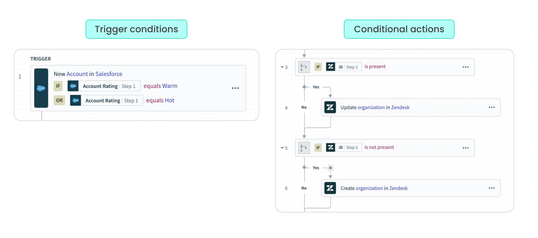

Back to basics: what are conditions?
Conditions are additional rules that you may add to control the flow of your recipe. This allows you to create more precise automations based on your business needs.
Letโ€™s say you want to create a recipe that automatically escalates high priority support cases to the engineering team by connecting Salesforce to Jira โ€“ in this case, you may add a condition that limits only case types of Priority = High to be processed in your recipe.
In your recipe, you may include conditions in both triggers โ€“ trigger conditions โ€“ as well as actions โ€“ conditional actions.

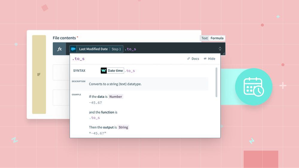

Using formula mode to convert your data type
Hereโ€™s how to troubleshoot the problem โ€“ use a formula to convert the current data type to your desired data type. Below, youโ€™ll find a step-by-step tutorial on how to convert a date data type to a string data type.
In this example, we want to set up a trigger to filter for new or updated Salesforce cases that was last modified only in 2022. In summary:
  • Trigger data: Last Modified Date
  • Condition: contains
  • Value: 2022
โš™๏ธ Get the step-by-step for this hack and more from Workato's Product Hub: https://www.workato.com/product-hub/date-conditions-unaccepted-data-type/?utm_source=WorkatoPros&utm...
