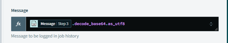

Alternatively, if you’re okay storing a non-human-readable version, please use the formula as specified below
It will be stored in the Data Table column, and you can use the data again in subsequent recipes.
You can also convert it back to a human-readable form using decoding and decompression when needed.
