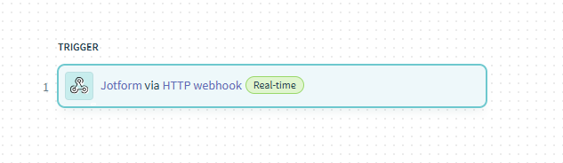

Step 1: Create a recipe with the Webhook triggerScreenshot 2024-12-10 162459.png

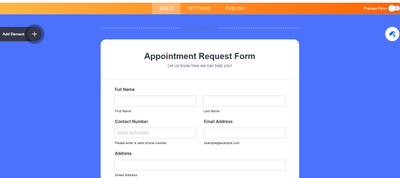

Step 2: Open the form that you have to connect to the Workato to process the submissions:
Example: I've created a sample Appointment form

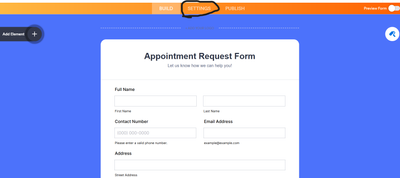

Step 3: Open the settings tab on the form

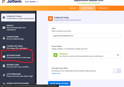

Step 4: Click on the Integrations tab in the left hand side

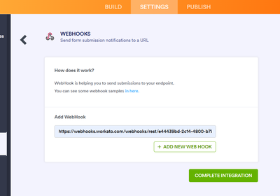

Step 6: copy the webhook end point that generated in the workato and past it in the 'Add Webhook' field and click on complete integration and click on Finish
Example:

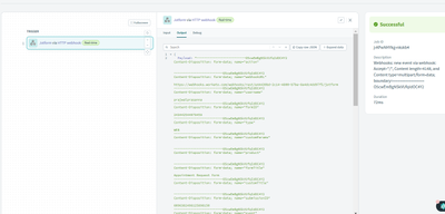

Step 7: you can now submit the form to check if the webhook is working or receiving the request from the JotForms.
Example webhook payload:
