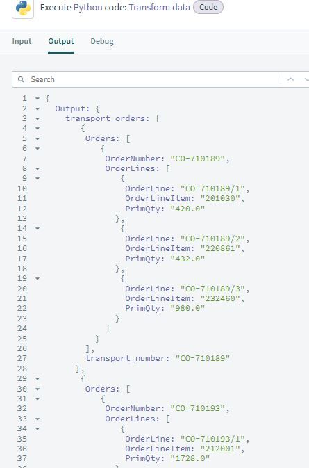

But when I try to use the output in the next step, the array stays empty.
Might it be that the TransportOrders should be an object instead of an array?

I think it's a case sensitivity issue. Your schema screenshot says "TransportOrders", your output screenshot says "transport_orders", and your script screenshot has "Transportorders"
Workato tends to automatically update CamelCase to snake_case (very annoying, but it's only when displaying input/output) , so I think all you need to do is update your code to "TransportOrders" and you'll be set. Hopefully that works.

you are absolutely right.
i got it working. thanks!
