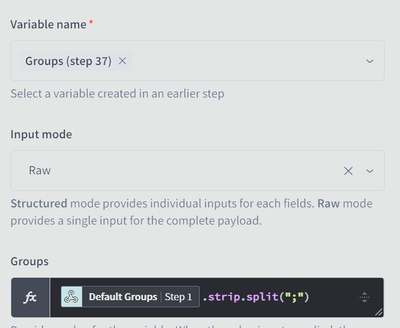

I create a variable, set it as a List type. I then update the variable and set the contents from a split string:

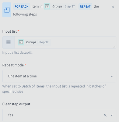

In the For Each I reference the List variable:

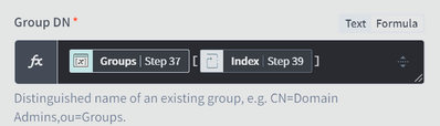

I got there in the end. I had to use the List variable with the Index data pill:

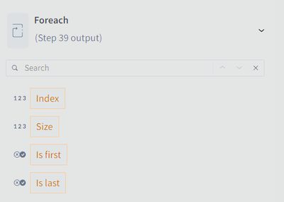

Within the loop branch action, I can only see Index, Size, Is first and Is last data pills
The Foreach output looks like this in the job history:
Index: 0,
Is first: true,
Is last: false,
Item:
value: CN=o365_Office365_E5,OU=Office 365 Licensing,OU=Groups,OU=Common,OU=Enterprise,OU=xxx,DC=xxx,DC=xxx
a week ago
Sorry I'm late to the party, but as you discovered the for each loop doesn't handle primitive arrays very well. That way you solved it is probably the most efficient way in terms of task usage.
