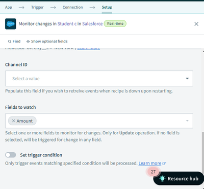

HI @pavan-narayan  , I've attempted to utilize the "Monitor changes in custom objects" trigger, and I successfully received events from Salesforce. I've included a link to my recipe for your review. It's possible that the issue could be attributed to technical glitches, so I recommend attempting to reconnect your connector and trying again.
https://app.workato.com/recipes/41502134?st=653ffd10f895683c79828783a550efc6d0a4788a3d4a9d1b6067b1db...
Screenshot of connector configurations.
