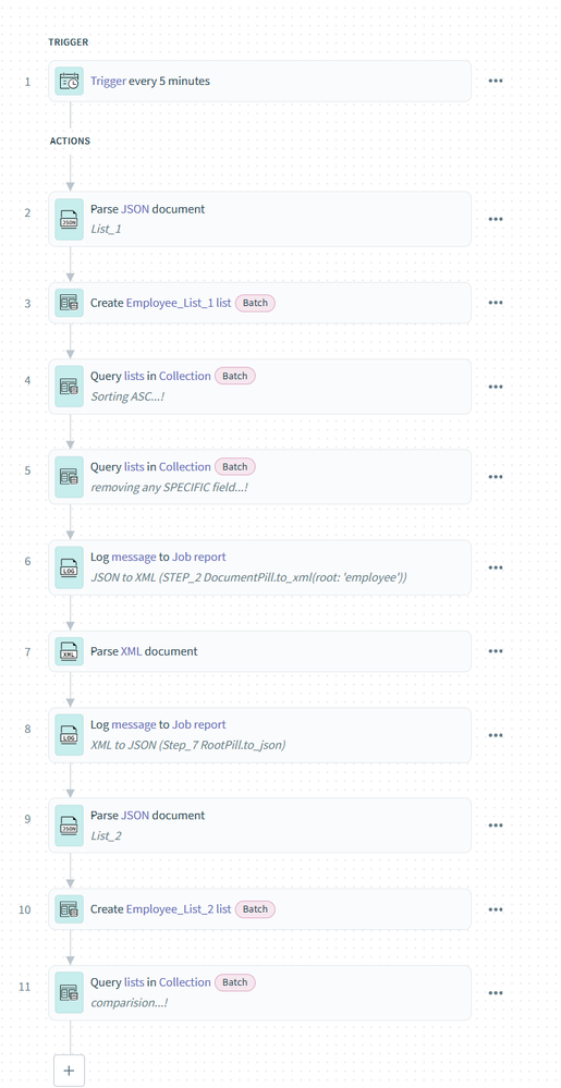

I want to achieve below functionality in Workato without Ruby / Java Script / Python Scripting as scripts are not allowed by our customer .Also JSON Transformations by Workato Action not available in my plan .Without these is there a way to acheive below ?
1) Sort a input json alphabetically ascedending
2) Remove any specific fields from a input json and return updated json
3)Convert any given input json to xml and any given input xml to json
4) Compare 2 json elment structure and return any field mismatch between the 2 json which is present in 1 json not the other json
โ11-03-2025 07:56 AM - edited โ11-03-2025 09:03 AM
HI @amit_mohanty88,
Have you tried using SQL Collections by Workato?? like below
Thanks,
J Rajesh Kumar.

โ11-04-2025 10:50 PM
Hi @shivakumara ,
Thank you for your valuable suggestion and the additional step.
Hereโs my thought process:
As per @amit_mohanty88's question, the goal was to verify whether each scenario is possible or not. Hence, I designed the flow in such a way to demonstrate all the possibilities.
Agreed with your point regarding optimization.
Thanks again for your inputs!
Thanks & Regards,
J Rajesh Kumar.
