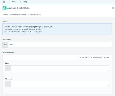

If you have many PDFs to send, you have to first put them into a list. The list should have two pieces of data:
  1. The file data OR a file URL
  2. A filename (but if not you can always construct one)
If they're already in a list with this data, then you're halfway there.
If they're not in a list, then you need to make a list to add them into, like this:
Then add each of your PDFs to this list. There are a bunch of different ways to do this, but I'd need to know more about your source data.
