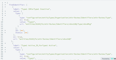

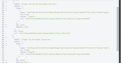

I have an array of complex data (see screen shot) - I want to find the top level array where an inner level value is matched
In the example below there are 3 main array elements - and in a nested level for Type  there is a value of 'Type1' for 2 of the 3 items in the outer array.
Is there a way to return only the array elements that are of  value 'Type1' in the example below?  Only thing I've found that I can do is create a List (Workato variables) and map the 'value' fields for Type, ID, Status fields...and then filter the list for what I want.  Was hoping to find a way to do this all inside a formula in order to facilitate bulk operations.  I've played around with .where condition in multiple ways but simply haven't been able to figure out what syntax I can use to filter the list so that the whole outer array item is returned.  I can pluck my way down to the inner list...but then I lose the other fields and only have the plucked field...which is not useful..  want to filter on 'Type' and use that to get the value for 'ID'

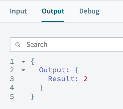

Run it, and you'll get this as output:

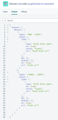

And here is the result:
