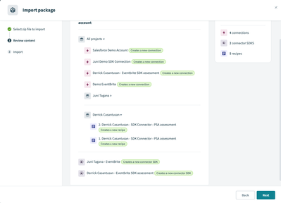

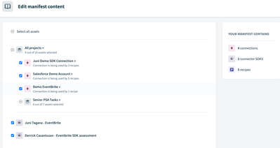

Thanks for the clarification. Suppose you will be using an SDK across a different Data Center; I would advise using Recipe Lifecycle Management to Export the recipe and SDK connector. It will create a manifest, which you can import to another account from a different data center.
Here's a sample of the manifest:

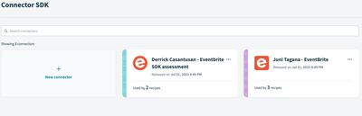

ahanumantharaya
@sampath  You can ask Support team to publish your custom connector in various region. Currently they publish it in region where your instance is.
