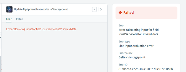

4 weeks ago
Hello,
I think you are correct about the type of input being the issue. I first tried with the formula as you've shown, but it still errored. I changed the formula to: &.to_s.to_date(format:"YYYY/MM/DD") - this time getting the nil input error. I then tried: &.to_s&.to_date(format:"YYYY/MM/DD"), and it no longer errors on empty inputs, but it does say invalid date for datapills that are not empty. I noticed that the trigger output has 0022 as the year instead of 2022, so I changed the formula format to be YY/MM/DD, but I still see invalid date.
What do you think I am missing?
Thanks for your help,
Renee
4 weeks ago
If your Last Provision Date is "0022-05-15", you're kind of hosed because that's not a valid date whether it's a string type or date type. You need to fix that first -- which should probably be fixed upstream in the source application providing the data. The to_date method won't work with "22-05-15". The year needs to be a 4-digit year value.
You can do something wild like this. It assumes all years are 2000 or greater. If you have a year in the 1900s, you're hosed again.
["0022-05-15".split("-")[0].to_i + 2000, "0022-05-15"[5..-1]].smart_join("-").to_date
## output >> "2022-05-15" as date type
