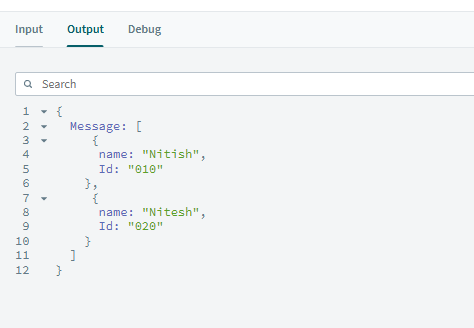

in logger it removes by using "- [{}]" but how do I remove it in actual?

HI @shivakumara
Thanks for checking, I have a parse json where I'm creating a json structure and later on I'm using list where I checks some condition in all fields and get some empty objects in filtered response.
now I want to remove those empty objects.
Please let me know an optimized  solution.
