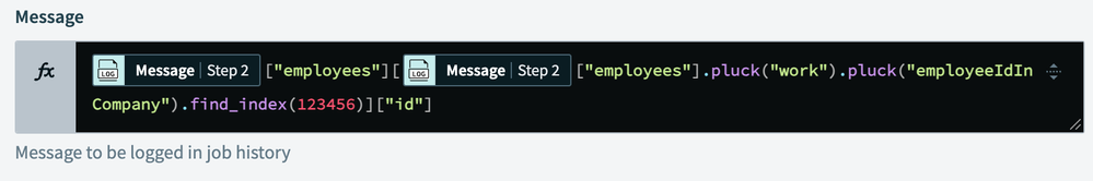

I put your sample payload in a logger message and accessed it from there. Assume "message" in the below is a data pill containing your sample data. If you already have a data pill for "employees", you can just use that instead of "message["employees"]"
message["employees"][message["employees"].pluck("work").pluck("employeeIdInCompany").find_index(123456)]["id"]
It should look like this:
Hope this helps!
