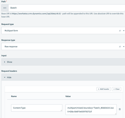

Hi @ryan-avent ,
On the custom action in Microsoft Dynamics, have you tried using a Raw response and adding the Content-Type on the Request Header? I can't see any similar use case, but I have tried this using a multipart form for GDrive, and it worked.
If it doesn't work; you can try using HTTP or SDK connector.

Hi @ryan-avent ,
