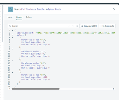

now to that second part of making a list. When I create a search to pull the QtyOnHand field and the NonNettable Qty from a warehouse
I get multiple records due to different warehouse codes
so how do I get these qtys into an List to than use in a loop and sum up? I thought the formula you just showed me was going to work till I realized there could be more than 1 warehouse code per company.
