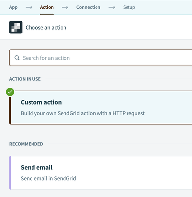

Check the "optional fields" section to see if it's present but just hidden. Maybe it's there?
Years ago I used the HTTP action so I could construct the SendGrid payload myself. I see the official connector also has a custom action you can use to do the same.
The SendGrid connector has a "custom action" option during set up. If you're unfamiliar with custom actions, they allow you to construct your own API call and handle the authentication using whatever connection you've chosen. Custom actions function almost identically to the standard Workato HTTP action.
You could use this to call SendGrid "manually". Using it will allow you to work around the limitation of the "Send email" action, but it's a little more work and requires more understanding of the SendGrid API (which I recall being pretty straightforward).

Thx for quick reply Gary! Yeah, nothing in the optional fields.
To make sure I understand your final sentence - in the official connector I don't actually see a way to construct that portion (the dynamic fields to populate the Sendgrid email template) of the Sendgrid payload. In essence, I suspect there'd need to be an input field/array called "dynamic template data" adjacent to the other input fields in the connector. But let me know if I'm missing something / misinterpreting your reply.

Ah, I catch your drift. Yep, this seems like the way to go. (And I agree with your assessment of Sendgrid's API - friendly/well-documented.) Thx again Gary!
