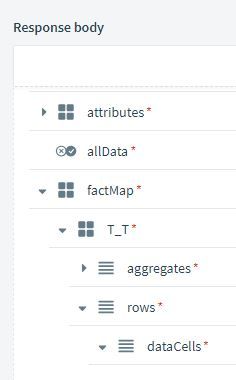

i have created a custom action in the SF connector to read a salesforce report
the report data is contained in an array called datacells inside an array called rows
i have put the response body view and the raw json below
what is the easiest way for me to parse this into a list so i can import to an invoices in an external system?
i tried creating a for...each loop on rows but workato errors out if i try to refer to data cells[x].label
i can for each on rows and then for each on data cells but then i can't tell where i am without a variable to track where i am which seems kludgy
the response body looks like this in workato
the raw json looks like this

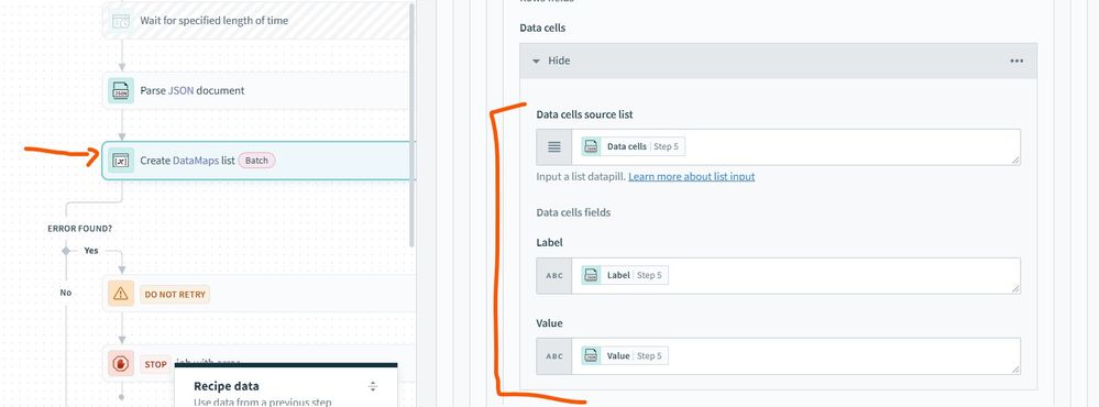

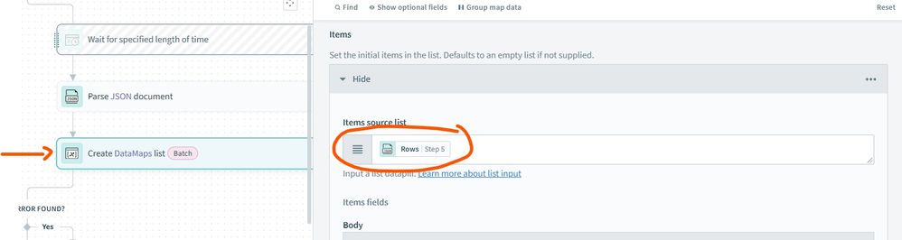

Hi @sidjayawardena ,
Here is my thoughts on the requirement.
1. Use Parse Json in sample document provide with above data, and for the actual document "map the actual data coming from source"
2. Use the create list initialize or you can map directly to incoming parsed value from step_1. Please refer below images for the reference.
Thanks and Regards,
Shivakumara Avadhani
Thanks and Regards,
