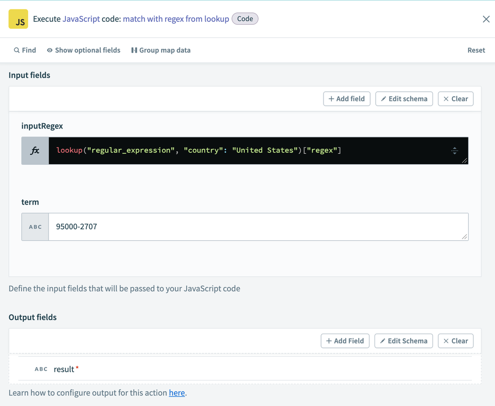

You would be able to do this with the Ruby "send" method, something like this:
[postal_code].send("match", regex)
But alas, Workato doesn't support "send".
However, you can still do this with a JavaScript action.
Set it up like this:
And use this code:
exports.main = async ( {term, inputRegex}) => {
var reg = new RegExp(inputRegex);
result = reg.test(term);
console.log(reg);
return { result };
Hope this helps!

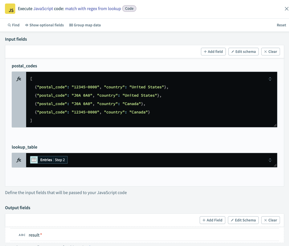

I tried this out and worked. Quick question, I'm trying to map and update batch of 100+ records in this use case. With this method, is there a way I can map the batch record? Or do I need to loop each record to with the Javascript action?
โ06-05-2024 09:48 AM - edited โ06-05-2024 09:49 AM
Glad this worked.
It's possible to do this in batches. Here's the updated code.
The postal_codes input is an array of postal codes and countries. You'll need to match this format from your source data.
The lookup_table input is the entire lookup table (use the "Get all entries from..." action)
And here's the updated code:
exports.main = async ( {postal_codes, lookup_table} ) => {

FYI, there's no error handling in this, so if the lookup fails, the whole thing might crash. JavaScript is not my native tongue ๐
