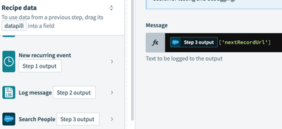

Hi @prp_proton ,
An alternate solution is using a formula to pluck the nextRecordsUrl as a datapill. See sample below:

Hi @prp_proton ,
