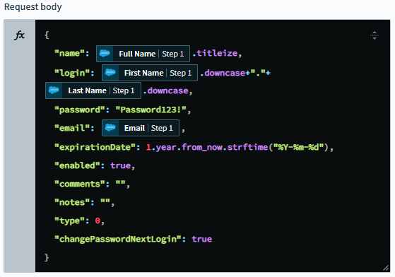

Here's screenshot of my formulas. This show all the formulas that I'd like to use, but I still get the 415 error even when "name" is the only field with a formula and the rest are replaced with hardcoded values. I agree that it would be great to get to the root of the issue!

In formula mode you have to quote your text.  In your example, I think you'd have to wrap the whole thing in single-quotes, either that or use double-quotes but then use single-quotes for the key-value pairs.  I think you'd also have to close the text and add the variables outside the text, like in programming.  That's where I think it gets really confusing/ugly, and which is why I (like Gary) tend to do that stuff outside of the body.  For example, I think it would look something like...
"{ 'name':'" + <FullName-DataPill>.titleize + ",
'login':'" + <FirstName-DataPill>.downcase + "." + <LastName-DataPill>.downcase + ",  ....
etc etc.  You could play with it using just one field at a time to see if you got the syntax right.  But troubleshooting is certainly easier using variables beforehand.  BUT, it's more Tasks!  So then there's that.
