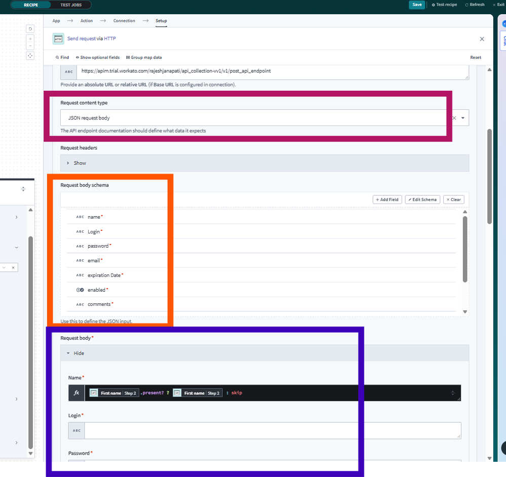

Hi @dstein61 @gary1 @mppowe,
One solution I would suggest is, instead of using an additional variable (CDM) or directly applying formulas in the HTTP step request body, you can select JSON Request Body in the HTTP step rather than Raw JSON Request Body.
When you choose JSON Request Body as the Request Content Type, you can define the schema based on your request payload. This allows you to easily map data pills from previous steps without writing formulas manually.
For your reference, I am attaching an image. With this approach, there is no need for any additional steps.
