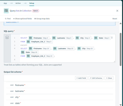

Hi @amit_mohanty88,
It can be possible with any type of json, with respect to that we need to provide the sample json in the Parse Json step.
Please find the below sample json data which i have used in step_2 and step_9 and output from step_11 and query:

Query:

@amit_mohanty88, Based on my analysis and understanding, if you want to execute a query in Workato, the input must be in a table-like structure in a collection.
Suggestions:
  1. My suggestion is that for scenarios where native Workato actions cannot handle the requirement, we should leverage scripting, that’s exactly why Workato introduced this capability. You can also communicate to the customer or business team that this particular scenario cannot be implemented without scripting, and the script involved is minimal, simple, and easy to understand, especially when it comes to data comparison.
  2. If the team is still not comfortable using scripting (Python), an alternative approach would be to convert the JSON into CSV  or send the data in CSV File, can read from any source system or store each required JSON field into a data table. Then, using SQL Transformations by Workato, you can easily compare both CSV files (file_1 and file_2) through a single query step.
In my view, it’s best to communicate this clearly to the team and proceed with the scripting approach, as it’s the simplest and most efficient way to handle this scenario.
