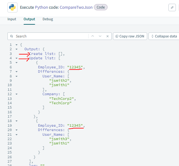

Hi @ankuragarawal ,
Assumptions: with the above requirements, you able to fetch the records from both Workday and Share-point application.
Problem statement: You need a help in comparing two output response of both the application (Workday and Share-point)
Solution:  Pass the both the response as input to the Python component and where create two list
                     1. Create_list: To create new records in  Share-point
                    2. Update_list: To update the existing records in Share-point
Feel free to reach out if you need any further assistance.
