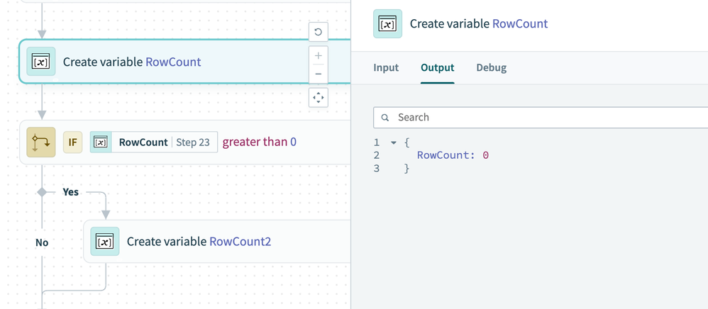

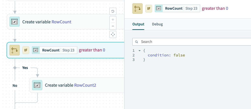

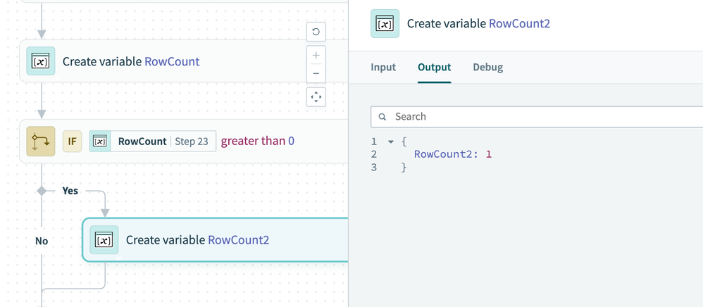

I have a simple IF condition checks if an integer variable is greater than zero.  When I run the job I can see that integer is in fact zero, and that the condition evaluates to false, but it is still executing the steps within the condition.
As a test to make sure the steps were truly nested within the condition, I changed the condition to if true equals false, which evaluated to false as expected, and skipped the contained steps, as expected.
I've also tried not equal to zero > condition is false as expected but the steps are executed.  And just for fun equal to zero > condition is true as expected and steps are executed as expected.

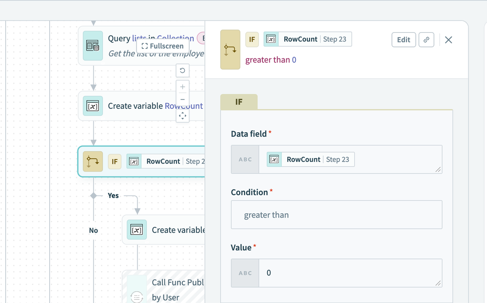

The first thing that came to mind to me was a data type issue, like comparing a string against a number.  But your screenshots show the variable is an integer, and the IF condition always says ABC.  But for chuckles, maybe try changing the IF to be formula mode and see if RowCount > 0 as the formula (and the condition just becomes "is true") and see what does?  You can also use some logger steps to evaluate formulas to see how they wind up, like RowCount = 0, RowCount = "0", etc.

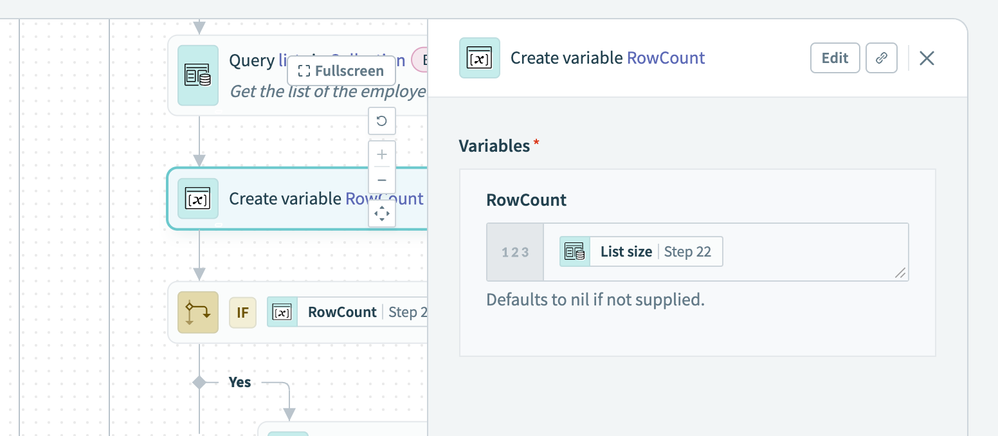

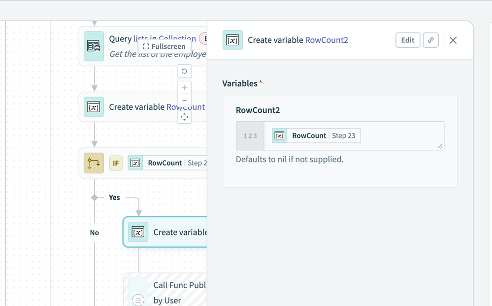

Can you share how the condition is written and maybe a screenshot of the input and output?
3 Define RowCount2 Variable.png2 Define Condition.png1 Define RowCount Variable.png6 Inspect RowCount2.png5 Inspect Condition.png4 Inspect RowCount.png
The screenshots didn't upload in order unfortunately, but there are 6 screenshots.  3 screenshots defining the RowCount variable, the condition and the RowCount2 variable... and 3 screenshots inspecting RowCount, the condition and RowCount2.  Thanks for taking a look!
