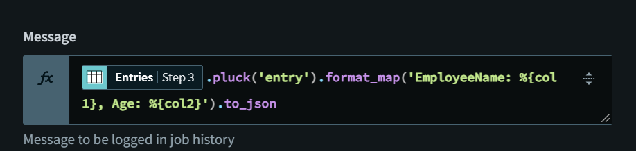

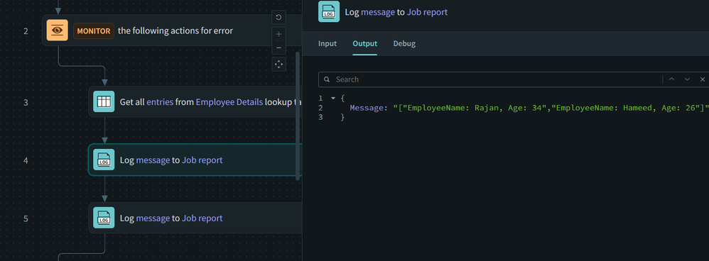

Hi @Ralef ,
Check out this solution does this helps you or not, it will not take any additional task too.
Explanation:
We can define the column as per our requirement using 'format_map' at the end we can format using to_json.
